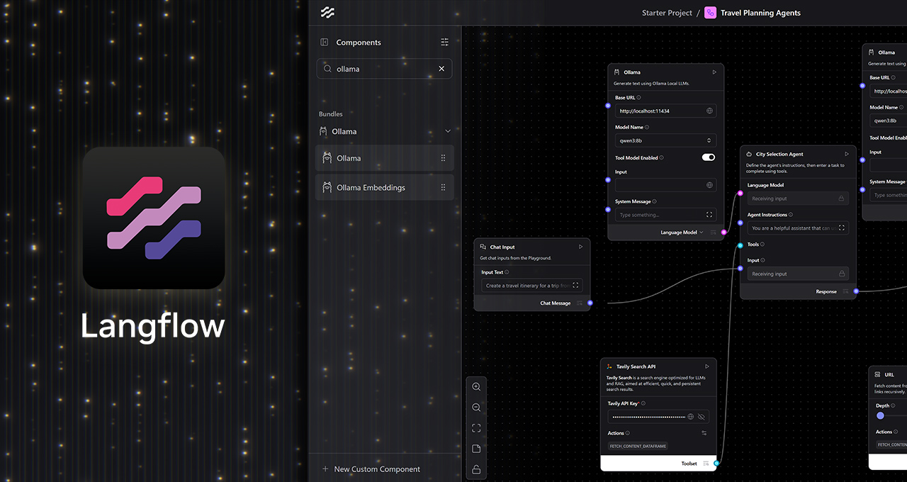

  • Install the Langflow desktop app for Windows.
  • Install Ollama, then run Ollama and launch the preferred model (Llama 3.1 8B or Qwen3 4B recommended for users’ first workflow).

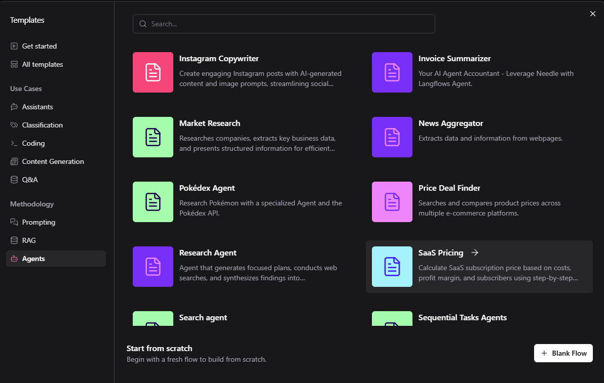

  • Run Langflow and select a starter.

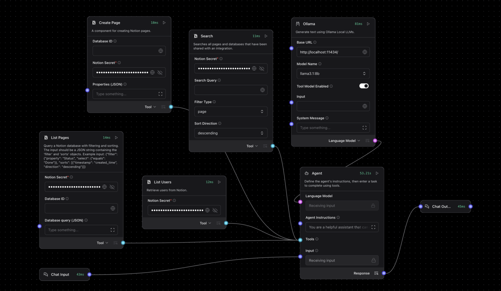

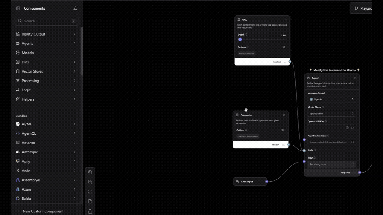

  • Replace cloud endpoints with local Ollama runtime. For agentic workflows, set the language model to Custom, drag an Ollama node to the canvas and connect the agent node’s custom model to the Language Model output of the Ollama node.
Templates can be modified and expanded — such as by adding system commands, local file search or structured outputs — to meet advanced automation and assistant use cases.
